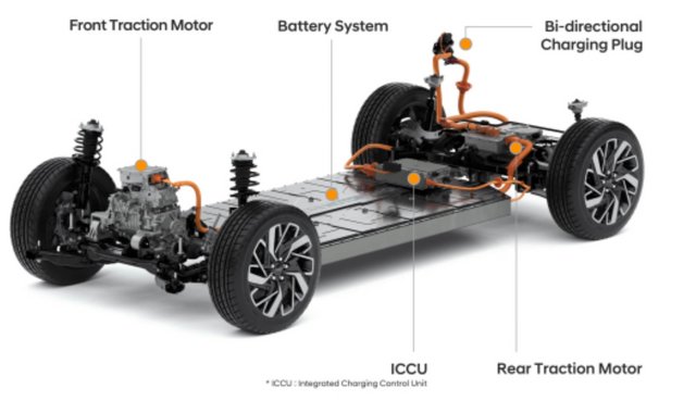

I just watched Korean YouTube and he is kind of Korean version of Sandy Munro. He recently tear down motors and some parts for ioniq5/ev6. He said stop charging/slow charging issue (with heat) can be ICCU. His suggestion was checking ICCU from the dealer then if the dealer find the faulty ICCU then replace it. If the dealer did not find ICCU issue then just use the car until ICCU stops to work since the car has the warranty.
What is ICCU? When I took my car to the dealer, they couldn't replicate the problem on their level 2 charger because it only does 6.6kW. They said the solution was to set the limit to 100%, haha total BS.
