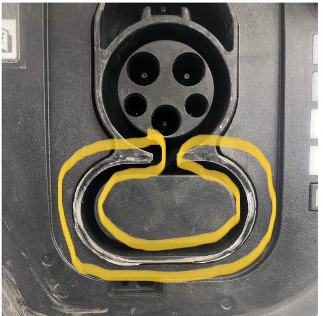

I had always read this prior to this post as meaning Essential had slower DC charging, but it's now clear that it means no DC charging.
@Buttermerck, you really got scammed by your dealership for selling such a useless car well over MSRP, but it seems like the only recourse would be based on the obviously misleading specs currently posted on Hyundai Canada's website. I suppose it's a good opportunity to hold Hyundai accountable for terrible dealership practices.
IMHO, it's absolute BS and false advertising on somebody's part. Hyundai Canada's current site lists the specs for fast charging the Essential, rating the times the same as the Preferred (both with the 58 kWh battery).
I agree with everyone finding it impossible to believe that any spec of I5 comes WITHOUT CCS. I'm not aware of ANY BEV sold right now without fast charging, an only the Leaf still ships without CCS (CHAdeMO instead).
That said, none of the evidence one way or the other actually adds up:
  • The essential, with a smaller pack, WILL charge slower - that's just physics. For comparison, the EV6 light, with the same size pack (which is 58kW not 55, I think OP is mistaken?) tops out at 180kW instead of 240. But it definitely comes with a CCS port! The point here is that materials showing the Preferred "adds" 350kW fast charging aren't the exception that prove the rule - that trim does charge faster.
  • Those materials are also wrong. No EGMP car charges at 350kW. The current crop top out at 240, so that language is fast and loose and not totally correct to begin with.
  • The table above shows that all trims have DC fast charging, but also fails to reflect the slower charge time of the smaller pack. So the table is definitely wrong in some regard about the Essential's capabilities. EDIT: this is actually wrong. The table does show the shorter AC and 50kW charge time of the smaller pack, and the 10-80 is probably just the same as the BMS will fast charge at 3.1C, resulting in the same duration for both pack sizes. I just didn’t read carefully enough. This is strongly suggestive that the essential is supposed to come with DCFC
Here's the test I really want to see from OP: Inside the trunk, there's an emergency release behind the charge port, so you can pull a little cable to unlock the charger lead if software goes wonky and tries to trap you at the station. Here's how to open it: Hyundai IONIQ 5 - How to manually release the charging cable from the charge port. - YouTube
With that little door off, try to get a picture of the back side of the charge port. It looks tight and maybe it's not obvious enough, but we should be able to see whether there are two big fat orange leads coming out near the bottom, or whether there are JUST the thinner AC cables.
Hopefully that will reveal whether the car literally has no DC inlet, or whether the factory simply installed an incorrect faceplate part covering over the pins.

Edit: so it looks like this is a lot trickier on the I5. My EV6 has a whole panel around the charge port that pops off. But you can clearly see in this image what I mean, where there’s a large bundle inside an orange conduit for the AC wires, and a totally separate bundle of two much larger wires for DC. See if you can make out the same behind your own charge port.

This is hard to believe.
The reason is….. the charging port was already used at level3 chargers.
If this charging port was only used at level2, bottom plastic should not have any white scratches since Level2 chargers only use top part.
did you get used car? If you bought new car then bring it to your dealer and ask for replacement of charging port.
Nice catch @kimguroo .
Comparing this shot with the others in this thread that have the proper cap attached, the dirt residue surrounding the DC pin area are the same.
Meanwhile, the attachment point for the cap retainer is relatively clean. This leads me to believe now that the original cap was lost and it was replaced by what we see in the OP's posts.
I'm wondering why then, that the OP hasn't come back to the thread to state whether or not he attempted to remove the cap, if that's what it is.
Please OP, were you able to pry off the plastic cap.
I refuse to believe that Hyundai installed a unique port just on your car.
very probable theory: if bought used, the prior owner lost the OEM protection cap, and replaced it with the new in the pic, remove it and ask the dealer to install the proper cap.
if you bought it new, the dealer should replace the non standard cap with one that’s easy to remove for CCS charger.
ps use a plastic tool, the risk is minimal but 800V at 300A will hurt.
That's wild. At first thought I too thought the OP just neglected to remove the cap.
Looking at the photos, I too thought perhaps it is just a different cap. Looking more closely, the CCS 2-pin port looks to occupy the same space as that "fake cap", with the same gap allowing for the actual cap to go on. It does look like it actually does not have the CCS port.
Hmm, maybe my eyes are deceiving me but it looks like there is the shame of some kind of imprint of the CCS port (lighter patches) from the OP's photo:
Maybe those CCS ports are there after all under some kind of heavy duty cover or they've deliberately permanently capped them off - either way I'm curious to find out how this one goes!

As previously mentioned the "Essential" I5 model was an unique to Canada compliance model that allowed Hyundai to meet the minimum price threshold for 5K federal rebate eligibility on the entire I5 lineup. When I ordered my I5 back in Nov 2022, I briefly looked at the specs of this model and quickly realized that although the price was very attractive they specifically omitted DC charging as a feature in their online advertising. This being my 3rd Hyundai I have come to appreciate if they don't list an item as a distinct feature on a particular model but do in others it means that feature is not present in that model, regardless if they further implied in other literature specific level 3 DC charge speeds. This is a question of buyer assuming commonly available EV features would be present on a stripped compliance model. If there was confusion on OPs part it should have been addressed at or before delivery with the dealer.
There is no point in trying to pry a bonded DC port cover off that clearly is not meant to be. I strongly suspect there are no DC pins or DC wiring and probably different software disabling DC charging. Honestly I am surprised anyone in Canada bought these stripper models with smallest battery, crippled charging and no heat pump. I think the dealer overcharged the OP, may or may not have been deceptive about the model's features. Regardless the dealer should make an effort to get him into a more suitable vehicle. Unfortunately I don't see how this won't cost the OP more money. I hope I am wrong and the OP is made whole.
Discussion starter · #54 ·
Looks like it only as one orange cord. No level 3 cables inside
Well that completely confirms it then. The car shipped without DC fast charging. I didn’t even know it was possible. Im genuinely blown away that car even exists. That’s got to be like $100 worth of parts saved.

I’ve attempted many times to remove that cap. It’s one solid unit with the rest of the port.
