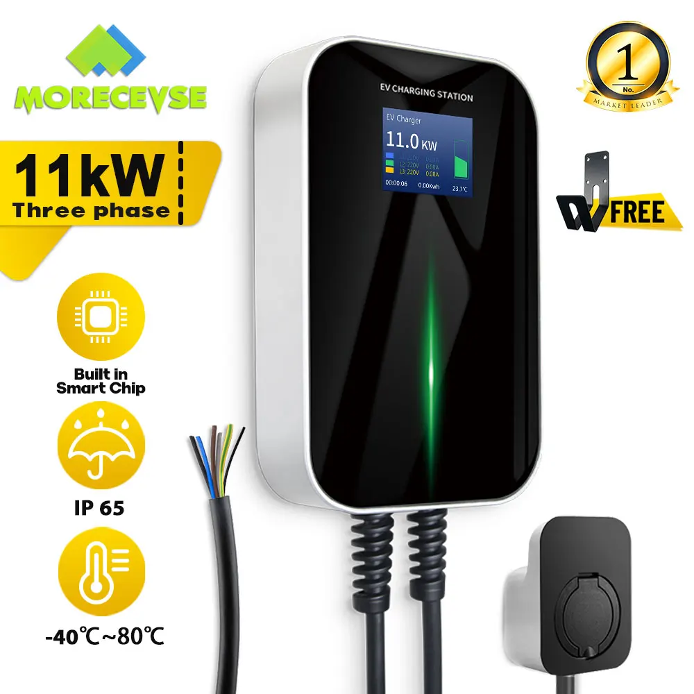

More about stuff nobody asked about haha!! Possibly helpful for someone. Most people dont know the actual charger is in the car and you only provide AC voltage via the fance wallbox.
The wallbox is only a glorified "Nema outlet" with a relay for safety and a small controll lead to the car that negitioates the available charging current.
So the car requests maybe 7kW and the wallbox says you can only have 4kW, then the car nods and adjusts to 4kW.
The smarter the wallbox the more fancy you can steer the control signal. For example by time tariff or load blaancing. Still only a very simple control signal you send to the car - no magic.
This is the circuit that sends the correct singal, $50. The rest of the $2k is in my eyes wasted money LOL. This little board can be controlled via a push button or via a potentiometer - or arduino.
As for me I got this type of wallbox, at the time it was $350. This bought me the little controller board, a relay for safety a current meter, a little color display, the charge cable with connector and a casing. It's a solid $350 unit worth the money. I would never imagine paying the $2k the local companies charger for a very similar product(in some cases the exact same unit even)
