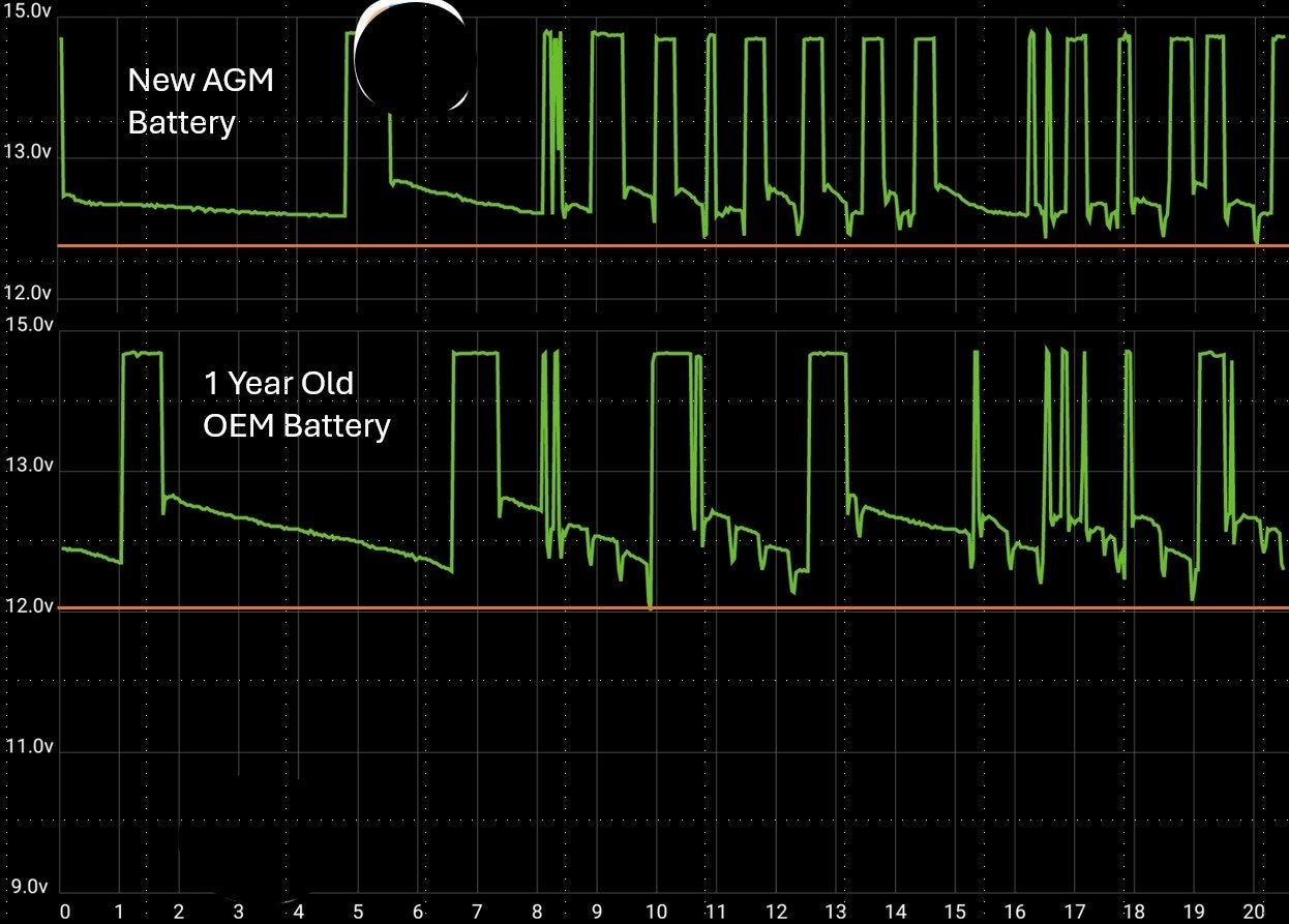

I mentioned this too in another thread. The charge controller is cooking the battery. Last week I put in an AGM battery. The factory battery I removed had been replaced under warranty just over a year ago, prior to my purchasing the car. My battery tester showed it to already be in a poor state of health, with barely 400 cold cranking amps in it, vs. the 650 it should have. Notably, my ICCU failed 5 months ago, though it was still charging the 12V battery.
These are the recharge profiles. The AGM is probably recharging more frequently because I also changed my dashcam settings for always-on sentry mode at the same time (thought I had already made that setting when I installed it).
Does this graph show just 1 day (20 hours), no driving? If so, you put a great strain on the 12v battery with the dashcam.
There seem to be some additional drain every 20-30 minutes, maybe Home Assistant integration, or utility company using your Bluelink?
